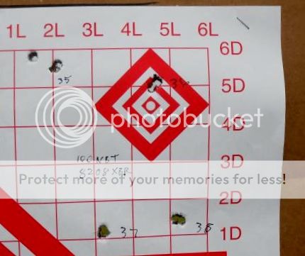

Bulldog284, I started at 35.5gr and went up to 39.0gr with bullets seated to a 0.020" jump. Be safe, please work up to max...
Mr. Big, what load are you using?
Mr. Big, that's some great shooting, was this a max load? I don't have any 100gr bullets but I do have Sierra and Berger 95's. I will reduce by 10% and start there. Thanks
