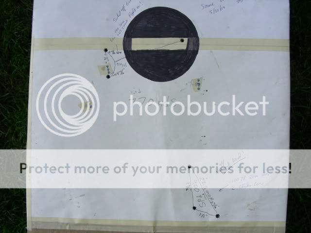

i'm gearing up a 6.5x47 lapua for an antelope hunt and figure 1k is my limit with 130's @ 690ft/lbs,more like 900yds)
,i reset my 100yd zero on the second group) in the ctr@900yds
the 6.5x284 would be a bit better but i will be running the 140's next,i have a 500yd load for them already but never went to 1k yet.
to sum it up,the 6.5x47 will do it@1k but the 6.5x284 should do it a little better :rolleyes:
770 covered with masking tape
900x3 low due to 100yd zero being off.3.5'ctc farthest.
3,one in and 2 left of clay bird outlined bull is at 900yds with the 130's.
