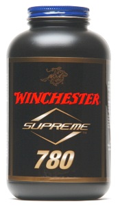

BillyK, thanks. I'm learning, slowly... Have you tried the new Hodgdon Supreme 780 or Hybrid 100V?
Ron
No I have not. I really like the Alliant powders. For me they have been the most consistent. I like some Hodgdon powders but I had some that were real inconsistent lot to lot.
I see that the Supreme 780 appears to be a lower density powder and probably better suited to the more overbore cases.
Ron
Ron-re22 fits the 6.5wssm absolutely perfect. I can't imagine the gun shooting any better than what it does. vv165 is a close second but cannot get the velocity of re22.
