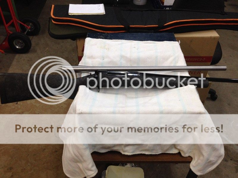

I stuck the tired old 270 donor rifle into the HS Precision stock and it feels great. I am going to stick with the stock Remington magazine for now and see how I feel down the track about converting to a detachable mag.

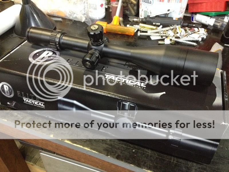

Got my scope today as well
I am going to need to fit some sort of adjustable cheek piece to the stock. I don't need much more height but will need a bit to get a good consistent cheek weld on the stock.
