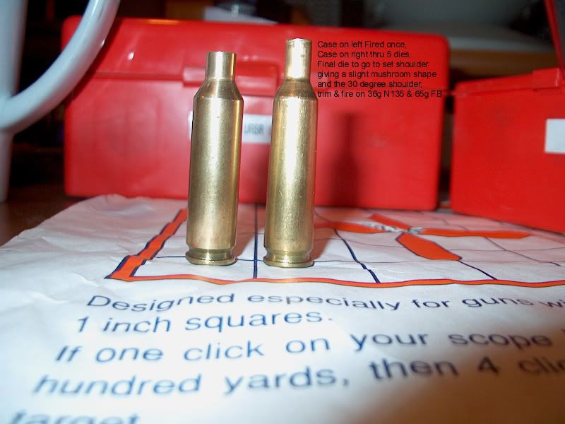

I went out today and fire formed some 308 URBR brass I had made into 6-250 30 degree Imp cases using N135 under 65g Shilen FB bullets in my 1:8 twist Gaillard barrel lite with WSR primers. Making the brass for a wildcat is all part of the fun and reward once you get it right, IMO. I guess that makes me more of a wildcatter than a shooter, but I do enjoy the later greatly too! It would be too easy to use a 6br or 6.5x47 and I'd have nothing to do in the frozen north in the winter.

I picked 36g as my fire forming load with these cases, went home, loaded up 48 more, went back out and fire formed them too. I was :D, not one single hang fire, even in this cold. I never had one sign of pressure at these velocity's/charges either so I could go up higher yet :cool: I was not after high velocity, I just wanted to fire form these cases and I have a few boxes of the 65g bullets around and many powders of N135 so I thought I would try it. I know I'm way over spinning these bullets with my 1:8 but for fire forming at point blank, who cares eh :)
I had a group measure .150" at 100 yds and one at 200 yds went .600" or 1/3 moa,pic below) on this second outing today. I held one of those 200 yds shoots off some since I could not see the group forming and I want to confirm I was printing were I thought I was,I guessed up 1 moa up from 100 yds, aimed and fired at this target) or she would have been at .400" center to center. I was using a 16x scope. Temp -6C or 21F. Wind was on my back, S 13 km or 8 mph.
Now all I have to do is ultrasonic clean the cases and match prep 'em,inside flash holes, uniform primer pockets depths, trim 'em all to the same length, outside neck debur and 30 degree inside chamfer, followed by another ultrasonic cleaning, weight 'em, and sort 'em by weight and do a H2O volume check of a few of them and cull any bad ones) :) Hoping for a 60 pk here of near perfect cases. :D

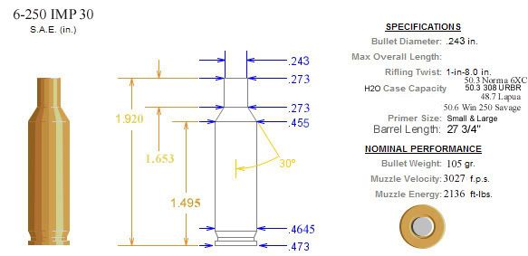

Here is the case best I can measure.
