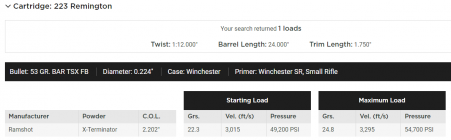

Ok guys thanks good information. I have a lot of terminator x I would like it to work anyone using that powder ?
I have only run a few Ramshot powders, and have not tried X-Terminator. However, the Hodgdon website shows their data for a 53 grain TSX which is a copper solid. SO close enough to say it is worth a try using a regular 53 cup-core bullet. I would put the 53 VMax at magazine length and give it a try, using all the best precautions as you get hotter.
I
View attachment 1524682Ok thanks
