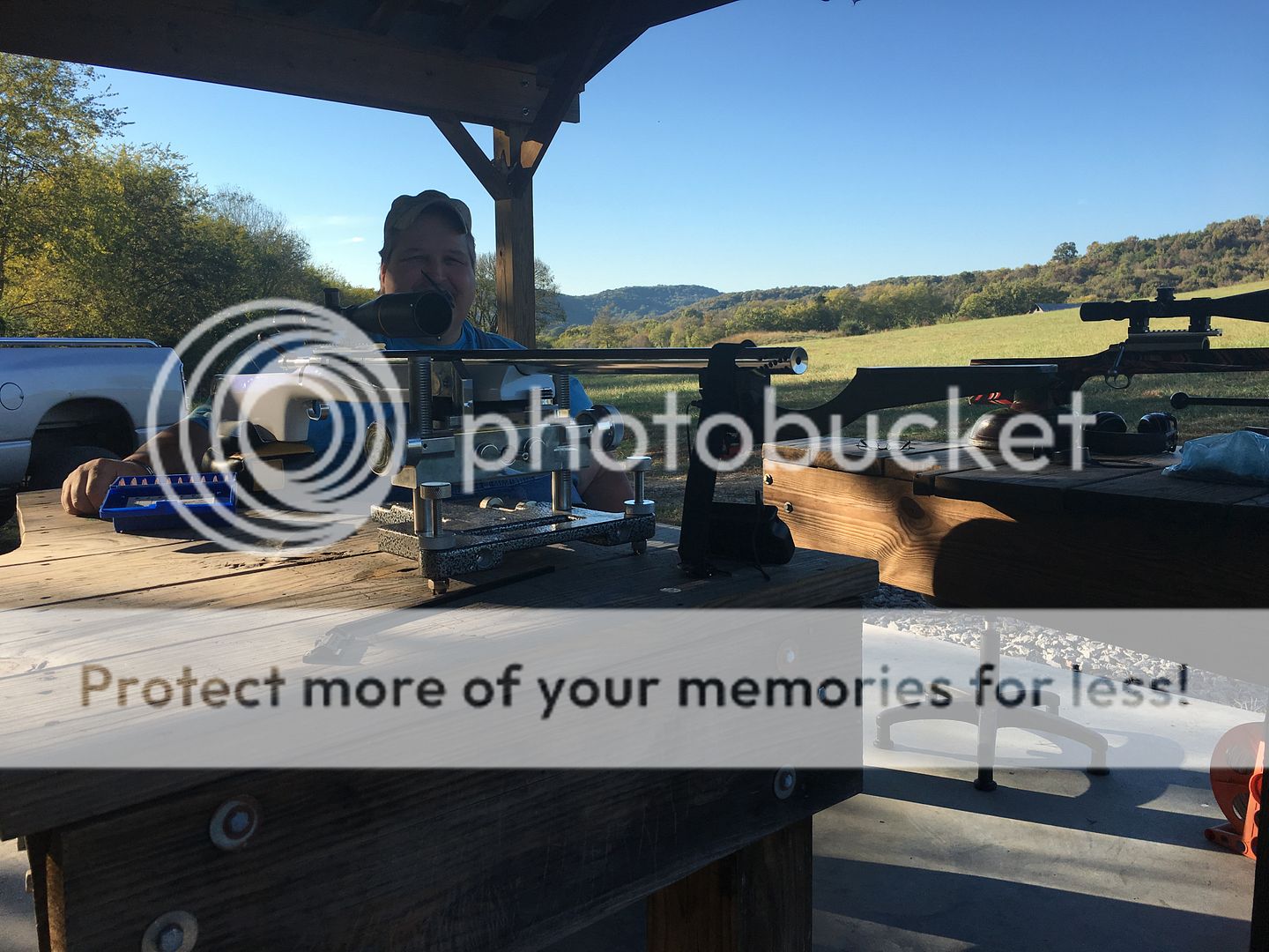

Shayne finishing the five shot string

No wonder Shayne has a smile on his face with a 5 shot string SD of 2 fps

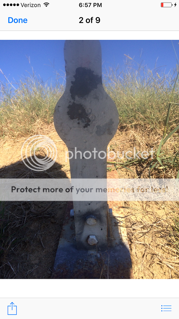

300 yds
This is two shots to the head and one heart shot at 300 yards
Only way I could hide Shayne's smile
