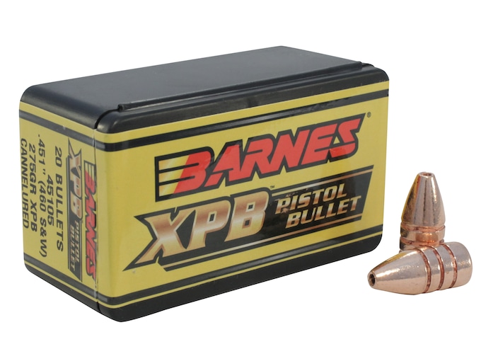

All my deer hunting for the last 40yrs has been up in the boreal forest of northern MN. I've had a total of 1 shot at 75yds and the rest 50 or under. My go-to recipe is the Barnes 200gr XPB, (the pointier one listed for the 460 S&W) over 41gr Lil Gun and Rem 7 1/2. 2500fps from my 20" 1:24 barrel and performs like this into sequential milk jugs full of water. Those petals are like copper Ginsu knives. ;)
I used to use the 200 FTX, also at 2500fps, but I didn't like spitting out bits of lead when eating my venison and wondering how much I missed. Whitetails aren't hard to kill, 200gr with this frontal area is plenty lethal.
