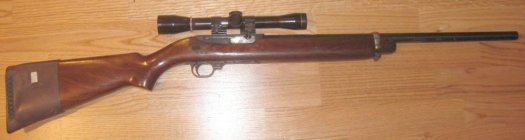

In my Smith 1988 6" 29-4 and in my 1962 Ruger 44 carbine [with a 22" Marlin 444 barrel], I shoot 24 gr H110 with 240 gr JHP at 1450 and 1800 fps 31kpsi.
The 44 magnum is SAAMI registered at 36 kpsi max average pressure.
