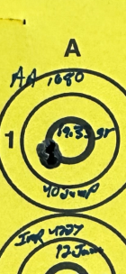

Ya sure about that ????View attachment 1558583
This from a little plain 221 FB …shot at 100yds from Kreiger #3 1-14” twist @ 22” …
a .045” jump tighten up even more…
Well sure. I certainly did not mean to imply they won't shoot. More that when you go for those high velocities they won't shoot those little bug holes repeatedly.
More reasonable speeds will most likely produce the little dots.
Either way, I stand corrected.
:D
Yeah, they shoot repeatedly at my little 2845FPs…
Just not sure most folks know how to tune a rifle, when they get 1/2-1/4” groups at 100yds & quit… & say good enough…
-I found a powder charge that printed small.-
Then spent awhile finding seating depths..
Shooting a ladder of 2 shots groups and a barrel warmer for when it cooled off completely- not get the barrel hot
Cleaning every 25rds- 3rds to get fouled in - fan blowing on barrel-
+12 to .080” jump using 2 shot groups to get 2 cut same hole-
Working on the smallest group printed-
Went back to powder charges- & added more to find max velocity & pressure signs in MY rifle- mostly way above what “book” suggests…
Then fine tune seating depth.003” both ways to see…
I found several velocity nodes & seating depths along the way.. from 67* in the morning to 92* in the evening-
Cause what works in morning won’t work in evening-
Also shooting over flags helps a bunch!!!
