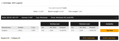

I was at the local Scheels this weekend and ran into a gent that was picking up a pound of lil gun to try. He also has the Hor 200gr muzzy bullets. He stated that he has tried H110 with good success (I believe he had a Savage Axis XP). He said the lil gun load data was on Hodgdon's website.

For 400L powder choices, it seems like your options are the slow pistol powders that work well in 44mag, 45 Colt, 454, and 460 (obviously not at the same quantity). Of those powders, it seems like H110 always gives the best velocity. As I understand it, N110 is just a little denser, so if the case capacity is the limiting factor, maybe N110 would be a better choice but those who have used it normally say that the H110 is almost gives a little more speed. When limited to 45ksi, I don't think the slower powders are going to generate enough pressure to be efficient, nor does cartridge have enough case capacity to hold enough of those powders to reach the those higher pressures. Maybe if you want to launch some heavy (+230gr) stuff out of a bolt gun, stuff like 4227, N120, and RL7 might be worth looking into, but I don't see a benefit to slinging heavier bullets out of a 400 Legend. Seems like 180-200gr would be more than enough for what the cartridge is intended for, and you could go a fair amount lighter with a soft monolithic.
