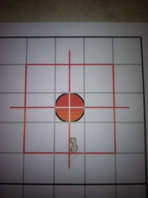

Well went out to the range this morning to finally test the 39 gr BK'S.
I shot 12 three shot groups. 6 groups with IMR 8208 XBR and 6 groups of H4895. The H4895 out preformed the XBR in stardard deviation, extreme spread and group sizes.
The load I am probably going to settle on is 27.7 gr of H4895 which gave me 3750 fps and a group size of .260.
I'll try to get a picture posted later.

Here is the picture of the target.
32dgrz
