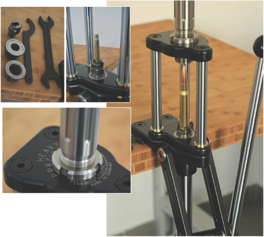

Then when you tire of putting your $400.00 dies into your $130.00 press you should consider this one:eek::
https://www.turban-cnc.de/index.php?article_id=72&clang=1
Enjoy!

I also have that press. Took a while to get it and their English is a bit to work through but the press is the best I have ever seen.

I think we can all agree with this statement. Unfortunately, the press from Canada is about $400.00 USD more than the Prazipress because our Canadian brothers charge for every adapter and shell holder which come with the German press. The large Prazipress (140mm) is $900.00 USD before shipping and paperwork with approximately one month lead time. The ATRP is $1,375.00 including all the adapters except the .50BMG. Personally, I don't care but I think costs like this should be pointed out to make equitable decisions. But I also believe that we should all choose what suits us as individuals since we are the one to please not the general membership. ;) And in reality, I believe it's better to have choices rather than limitations with regard to any of the resources we need or want to buy.
