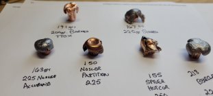

Been playing with loads over the winter, the old standard was 59.5 grains of Varget over a 225 grain Accubond, Partition, or Sierra....almost same POI @ 100 yards! very consistent. Played with RL-15 previously and had good results but the latest has been CFE 223. 2800 fps with 67 grains under a 225 grain Accubond or Sierra! 24 inch gain twist barrel, and the rifle is light, recoil is substantial at this upper load. I also worked up a load with the 250 grain Speer Hotcor, beautiful, 2650 fps under 64 grains of CFE223. I have started to play with the 200 grain TTSX but I have tones of Sierras, Accubonds, Partitions loaded up. I was shooting the bullets into some test media (wet newspaper & simulated shoulder scapula) no bad bullets in the bunch.
How did the 200gr ttsx testing go? Where they the BTs?
