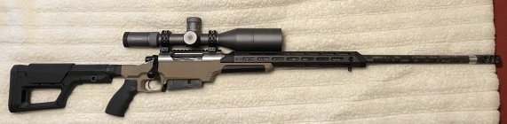

I’m sorry for kicking a dead horse on this subject but I am looking for insight.
I currently have a 338 lapua, with a 28 inch proof carbon barrel on a stiller action. I am currently loading up some 300 OTM bergers with N570. I am struggling to find a decent node/group. Anyone else have a similar set up and willing to share the load data?
Thanks so much!
