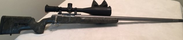

I think my 338 Lap Imp is a pretty garden variety 40° shoulder version. Mine is built on a BAT HRPIC single shot with a fluted Lilja finished at 30 that looks like a truck axel. My 338 Lap Imp and reamer print used for it. Redding made my dies back when Pat Ryan was still there.
