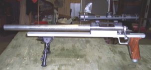

I got a 7mmBR XP100 Im changing to a 30 Bellm. I dont like fire forming but I guess I do now :-\. The dies werent that bad $82.00. Got a bunch of 7mmbr brass anyway.
I Live in Illinois and use mine for deer hunting. I shoot 125 grain Nosler ballistic tips and 33 grains of H4198. It is a very full case and a pretty hot load but it shoots very good.

Yep, my bolt gun has a magnum bolt face and will shoot both the cartridges made from 444 Marlin and the cases made from 7BR brass. They can also be made from 6BR Lapua brass if you choose. In my opinion a bolt gun is the way to go. There is no way you could shoot the load I am using in a Contender and I am getting 2800+ FPS out of mine with the 125 Grain Nosler Ballistic tips. My barrel is 18" long.
