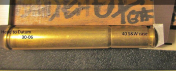

My recollection, and it could be wrong, is that the datum point on a .308 go gauge (or cartridge) is 0.400 in diameter on the shoulder.
SO -you could use a sized .40 smith and wesson cartridge (open side) on the shoulder of the gauge and measure from the base of the gauge to the base of the .40 cal cartridge. Compare the two measurements and see if they are different. (picture stolen from the internet)
Hope this helps,
Frank
Hope this helps,
Frank
You don't have to measure at any specific diameter for comparison. Anywhere on the shoulder will work as long as you measure both gauges the same way.
