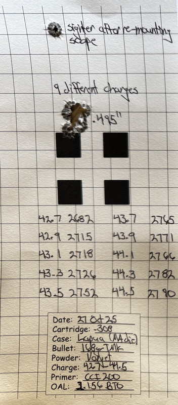

.308, Bisley Palma Chamber, Criterion Barrel and 168gr TMK
Just got back another barreled action from Jon Beanland. As usual, his work is impeccable and it always shows that on the targets. Wanted to see how it liked 168gr TMKs and get a feel for where my max was gonna be so loaded up a series of 10 rounds with .2gr between each charge. Bullets were lightly kissing the lands. 1st round was a sighter and shot the next nine into a group. Pretty sure this barrel likes this bullet.
