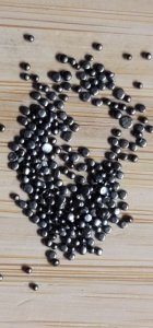

There's a big bonus to anyone that can Identify which powder Hornady has put into this 212gr ELD-X "Precision Hunter". It's cambered in 300PRC, COAL=3.6335, 79.9gr of powder and it whips out of a 26 inch barrel at 2931 @20 degrees Celsius if that helps anyone narrow down the performance range. I looked at pictures in Gordons for the most common ones but couldn't find anyting like this. It almost looks similar to a ball powder..whatsthis.jpg

I developed a 300 PRC load with 212 ELDXs for a buddy a while back. I pulled a bullet on a factory round from Hornady and it was a stick powder if I remember correctly. That picture looks like a Vit powder to me. 568 or 570? Either my memory is bad (possible) or they used a different powder in yours.
If it helps, his rifle tuned at 2920 with H1000 and the 212's jumped 0.020". It shoots very tight. I am currently trying 215 Hybrids in it now that they are back on the planet. They show great promise.
