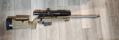

Just wanted to show off my 300 Prc build. Early 2000's mag action
Factory adjustable trigger
KRG Bravo stock filled with lead for weight
28" Mcgowen barrel 1-8 twist
Ec tuner brake
Tac ops scope bases
Riton x5 conquer 5-25x50
The complete rifle weighs 20 lbs. Target was at 100 yards after sight in, this was with factory hornady 225gr eldm. I have several hundred 220gr eldx waiting, 50 count of adg brass, ramshot magnum, retumbo, h1000. Ballistic-X-Export-2022-10-27 20_05_38.237906.png
Very nice! For me, factory ammo always leaves me with a desire to work up reloads that perform better.
In Hornady brass, my RPR likes the Berger 215gn hybrids with about 80 grains of H1000 for about 2900fps.
The 230gn A-Tips, with about 76 grains of Reloder 26 produce about the same velocity and accuracy as my 215 Berger combo. By the books, these are near max loads. Always start low and work your way up. For me, my loads with the Hornady brass did not transfer well when using Lapua or ADG brass. With Lapua and ADG brass, I use less powder to get to my desired velocity vs Hornady. Enjoy:)
