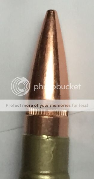

OK, i got my Lee dies in so I made up a test reference round using Hornadys 150gr FMJ B/T and set the bullet according to their load data with an OAL of 2.220" which only leaves .110" into the case not including the B/T. Does that look right? The case length is 1.355" FYI which I did not trim at all.
