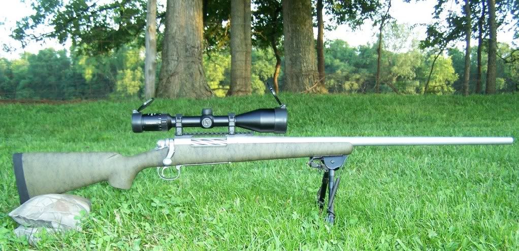

Just finished one......(10lb hunting rifle) I really like the .300 WM
