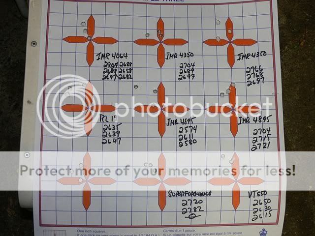

My 30-06 hunting loads don't include a 180gn bullet. I load SGK 150 and 165. Both are loaded to an overall length of 3.25, to fit mag length between my Weatherby Mark V and my sons Tikka. I just accepted that for length, then did round robin tests for charges. I load 50gn H4895 with the 150's for a nice local whitetail load. The 165's get 58gn of H4350, for a western muley load.
