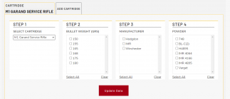

Hodgdon now shows Garand specific data, but most folks haven't noticed it is there in the drop down menu differently than for regular 30-06 data. Here ya go in case it helps put your mind at ease.
