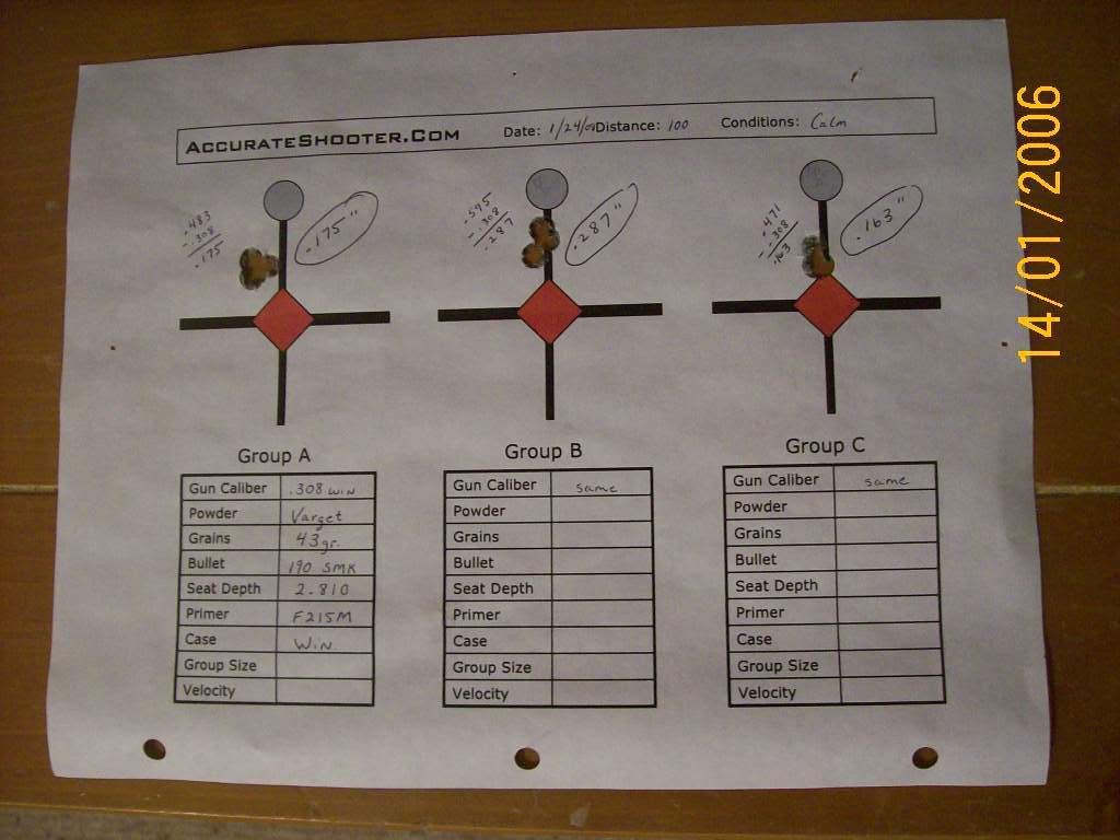

How do you like that target page? It was designed so you could line up your reticle on the black lines, and the Grey dot provides a second, higher reference point if you want to test a 200-yard zero.
The specs on the barrel is:
30" Pac-Nor 3 groove
12" twist
SS Super Match
11 degree crown
.308 obemeyer chamber
straight contour
Barrel has been shooting awesome........I love the targets too!!!
I've been using them for load development....The 42x Nightforce helps alot with splitting the diamond:thumb:
