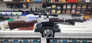

On the hunt for a set of 3/8" dovetail scope rings. Looking for a set of gloss see through for a 1" tube. Any reccomendations on where i may find a set? Seems nobody is selling gloss anymore and for cosmetic purposes i want gloss.

Appreciate it. I have a henry evil roy .22 that i would like to mount a gloss 4x leupold on. the hammer requires that i have a higher ring. if i have to go that high i would like to retain the ability to use the iron sights so using a 3/8 to pic rail id lose that option. i've scoured the internet and keep coming up dry. i'm watching ebay as well. leupold made the exact setup i need but the gloss has been discontinued. hoping i run across a set at some point. my other option is to get some brushed silver finish to match the action but i'd really prefer the gloss blued/black.
UTG makes 22/air rifle dovetail to Picatinny/Weaver adapters for using most standard rings. Might be easier to find gloss standard see thru rings and use adapters vs 3/8' dovetail rings in gloss. UTG adapters are available from Amazon, eBay, etc.
Mike, have you ever used any of these? i actually just ran across them this weekend and saved them on ebay. you are exactly correct weaver mount see through gloss/blued rings are much more readily available. with this being a 22 i'm sure they will be fine but figured i would ask before hitting buy.
I literally have bought dozens of sets for my rimfires and air rifles. Most of the time I then use Burris Weaver Sig Zs for rings. I've got a few sets just laying here taking up space. PM me your address and I'll send you a set for free. Mike
Thae rail adapters arrived along with a set of old stock blued weaver see through rings. Got the m83x32 gloss leupold mounted up and its exactly what i was looking for. Can still use the see open sights, i have sufficent clearance the thumb the hammer and it shoulders well. Overall very pleased, it gives that old school look and provides great function. Thanks again to @MikeT49 20251119_205807.jpg
