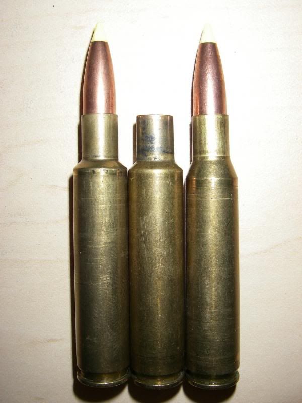

Here's a formed cartridge, fired case and one in 277 - 7 x 57 Mauser.

FYI...IT SHOOTS!
Chronographed in the mid 2700's with the fire-forming ammo I had. Looks like the cases formed fine. The few formed pieces I had, shot in the mid-2800's and seemed to group under 2 MOA with two different unknown bullets. Not great accuracy but this rifle has scope and bedding issues that I will soon resolve.
