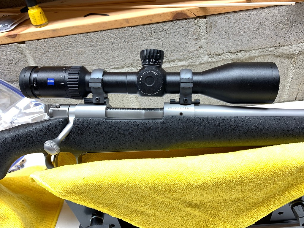

I am new to reloading the .264 Win Mag and was hoping to get some powder suggestions. I’ll start off shooting Barnes 120gn TSX and TTSX bullets.
The rifle is a Winchester M70 Extreme Weather. It will be used for deer and elk hunting in the Rocky Mountains, and antelope on the plains.
