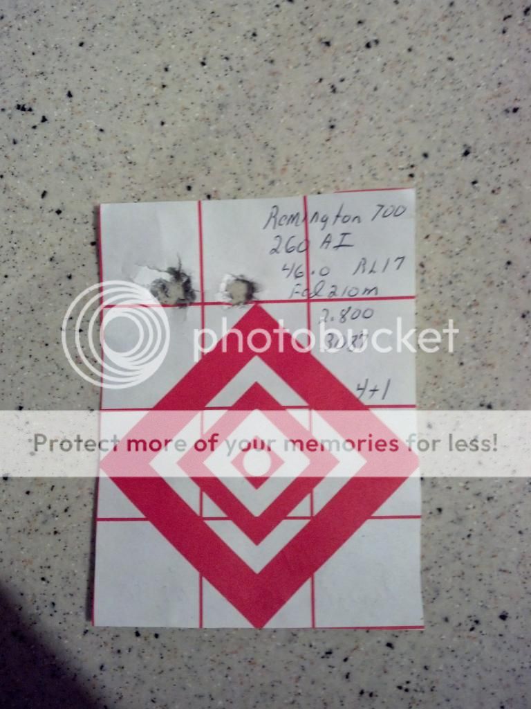

I have one on a Borden Alpine and one on a 700 S/A. 1 is 21" Brux #3 and the other is 22" Rock #2. Both are in McMillan Hunters Edge's and are a pleasure to carry and shoot.
I shoot 123 AMAX and 123 SST's in them and get 3090 and 3087 with RL 17.
I have also shot 130 Berger HVLD, 129 Nosler LRAB, and 130 Swift Scirocco. These bullets also shot pretty well, all under 1" at 100 for 3 shot groups.

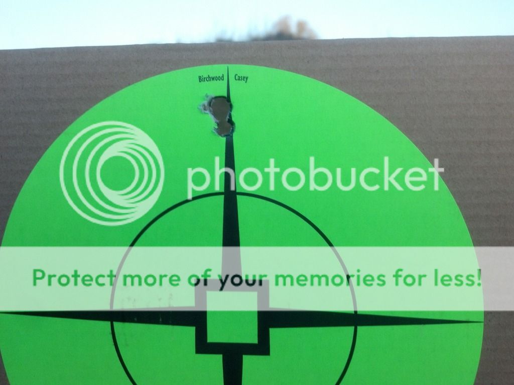

Pretty typical 3 out of the Alpine.
Alpine
5 from the Remington. I got a bit of target panic after the first 4 a blew this one up, I knew I did before looking.
Remington S/A

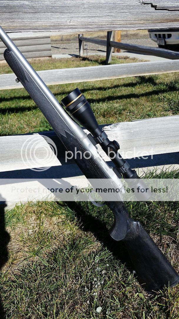

I have 7 1/4lb 700trued in a high-tech stk 4.5x14 leupold hart 24" 9 1/4 twist #3 fluted bbl 7/08AI I went to from 260ai which I could not get the velocity/accuracy out of that I had read about.
this 7-08ai will shoot into the .300 all day long when I am careful and push 140s at 3024
