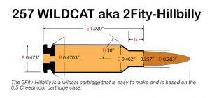

The 25 Creedmoor was a copy of the “2Fity-Hillbilly” that was a wildcat back in 2017. I have always wanted a 250 Savage for some unexplained reason. I have two different rifles in 257 Roberts. I only posed the question to find out if there was some "Magic" to the 25 Creed by comparison that I was not aware of. I have nothing at all against the Creedmoor cartridges... I have a 22 Creed and three 6.5 Creeds.
