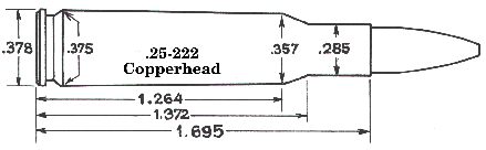

John Wooters came up with the .25 Copperhead using the .222 Rem. case necked up to accept the .257" bullets.

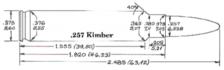

Kimber used the .222 Rem. Mag. case for their entry into the field for a little more power.

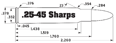

The .25/45 Sharps is the .223 Rem case necked up to use those same .257" bullets.
There was period of time where I was fascinated with the .222 and .222 Mag cases. In fact I managed to skip all the hoopla with the 6PPC to stay with the .222 Rem. in my short but enjoyable benchrest attempts. The .222 Rem case satisfied me and I did quite well with it until I move away from short range benchrest. I am fortunate enough though to still have a supply of both cases.
The .25 Copperhead though still resides in my equipment and gets called upon for prairie dogs, sage rats and ground hogs when the need arises.

If I recall correctly, didn't the 257 Kimber have a different shoulder than just necking up the 222 Rem Mag case?
Read somewhere that you had to jam the bullet into the lands to fireform due to different shoulder.

Have been tossing about doing a build on the 25-45 Sharps.
