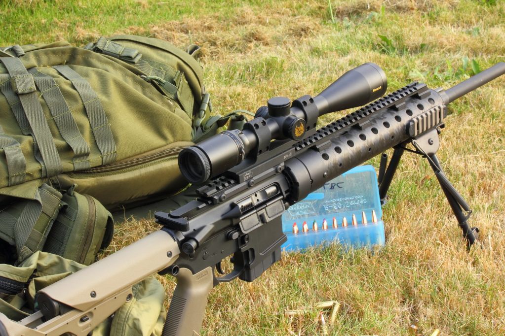

Greetings. I thought I had been a forum member here before but I guess I just lurked and drooled a lot. I have managed to find some great information for loading and caring for my bolt rifles (.243 Win and .22 PPC) and I guess it's time I make some posts.
In the past I've built a number of AR15 rifles but all of them have been in .223 and nothing out of the ordinary. This particular rifle is a .243 LBC, which is a 6PPC with the shoulder moved forward a touch.
The barrel and bolt are from Black Hole Weaponry in Moses Lake, WA and I assembled it all on a Mega billet upper and lower, with other bits and pieces to fill it out. I had to pirate glass from one of my bolt rifles, a Nikon 4-16 x 42 SF that has served me well enough.
I bought the .243 LBC because I wanted to build something for longer distance work that was light enough to carry, and still be legal for deer. I'd seen posts of people claiming very tiny groups and that always gets my attention too.
So far I've not enjoyed any single hole targets with it. It's really not shooting any better than any of the .223 ARs I've built and dialed in. I've tried various combinations of bullets and powder that brought other people luck but so far it's been happiest with the 87 Vmax pushed by Varget and another load of 58 Vmax being pushed by N133.
I'm curious if others in this forum have been shooting this round, and what kind of luck you've had with it. By its pedigree it should be quite a round.

Nice buttstock Assy. Whose is that?

Thanks for the offer. The 243 LBC is identical to the 6mm AR. It's just a 6.5 Grendel necked to 6mm. I don't even have dies, I'm just using 6PPC dies moved up enough to chamber the brass.
I would welcome any input as far as loads to pursue.
The butt stock is a Magpul UBR. It's rock solid.
