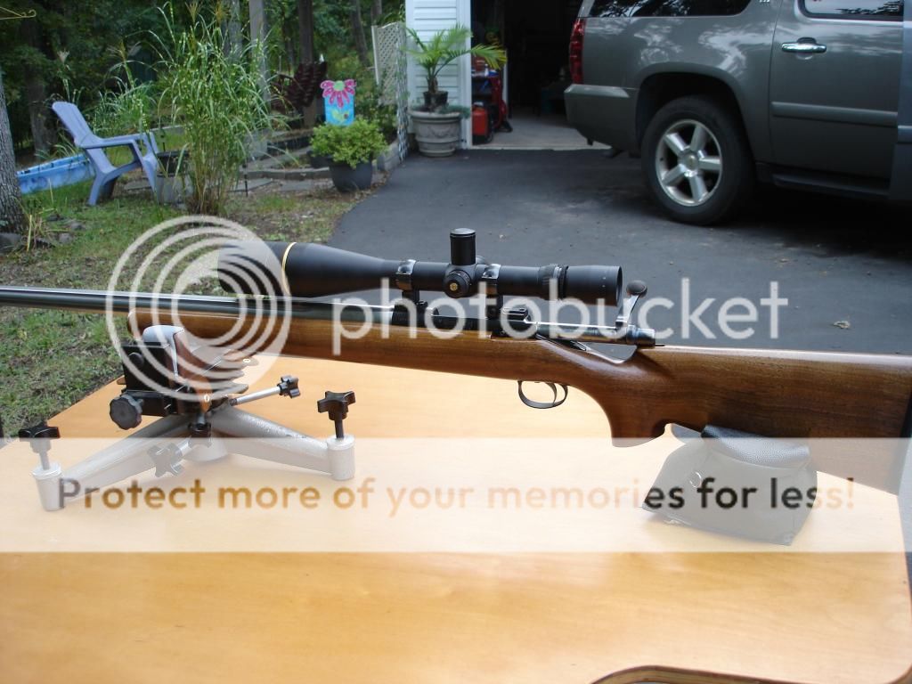

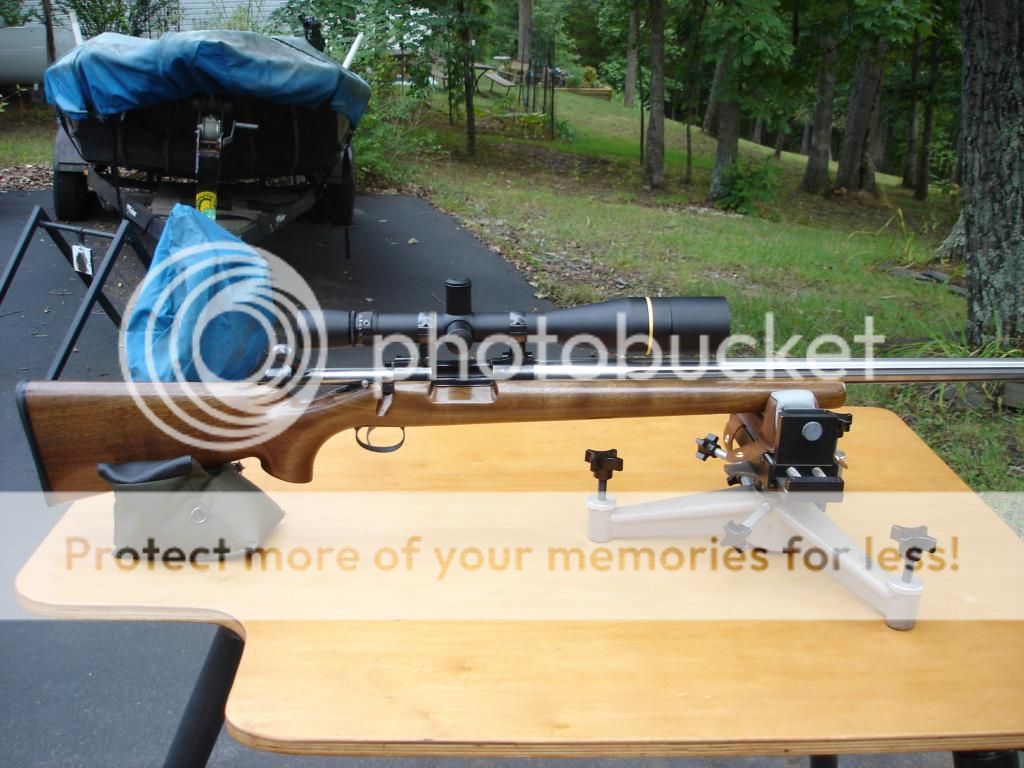

Finally got the rifle set up the way I wanted. Originally had a bench rest stock on it but switched it out for a more traditional one.
Rifle specs:
22BR caliber
Remington 40X action
Remington 40X stock with barrel tuners and accessory rail in forearm
Bartlein 1-12 twist fluted barrel finished at 26"
Jewell trigger set at 5oz.
Leupold rings
Leupold 8.5-25x50 with the varmint hunter reticle
Load data is 29.6gr. of Benchmark,Rem 7 1/2 primer,50gr. Vmax,Lapua brass.

Yes, I would agree you have a nice set-up and recipe. You're at .086" center-to-center for your three shots, which is outstanding...congrats!!
very nice set up and a shooter ! i have a 14 and a 12 twist and the 12 twist really shines with 60-64 gr bullets and slower powder...n540. i[m not sure why, but both of my 22 BRS shoot best with slower powder. lighter bullets did well, however, with faster powders,but, heavies like the slower stuff. one mistake i made was using my 6 BR body die to size and push shoulders back on the 22 BR cases. i just got a 22 BR type s fl bushing die and things are good again. are you shooting paper, varmints or both?
Thanks guys. Couldn't be happier.
The rifle will be used for ground hogs here in WV and a yearly visit to Wyoming to bust some prairie dogs.
Also "Preacher" here on the forums chambered the barrel so I think he deserves most of the credit on how accurate it is.
Dave
I personally love the appearance of the 40X in walnut. I have several and have found them all to be excellent chuck buster's. Very nice set-up, great choice in rest (love my Bald Eagle as well) and good choice in cartridge. Fine shooting. Hopefully no WV groundhogs are reading this forum, cause they will up and move! ;D
Carry on!
Snert
