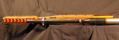

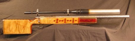

Kenny, no regretably this in not my rifle.
I first stumbled upon it when i was reserching set triggers. After a week or so i wished i'd saved a pic of the trigger setup and the stock but was unable to find it again. A few monthes later i found it again while researching the .224 Rem. Jet. I saved all the pics they had but the price was over $3000 so this piece of art wasn't within my means.
Jack Childress (im not familure with his work) if nothing else could shure make a beautiful rifle. All the metal parts were machine turned, and the stock is simply magnificant. The Unertl scope with the brass sunshade adaptor and long sunshade realy ads to the looks. This is the rifle that caused me to stumble upon benchrest guns and therby the sport.
