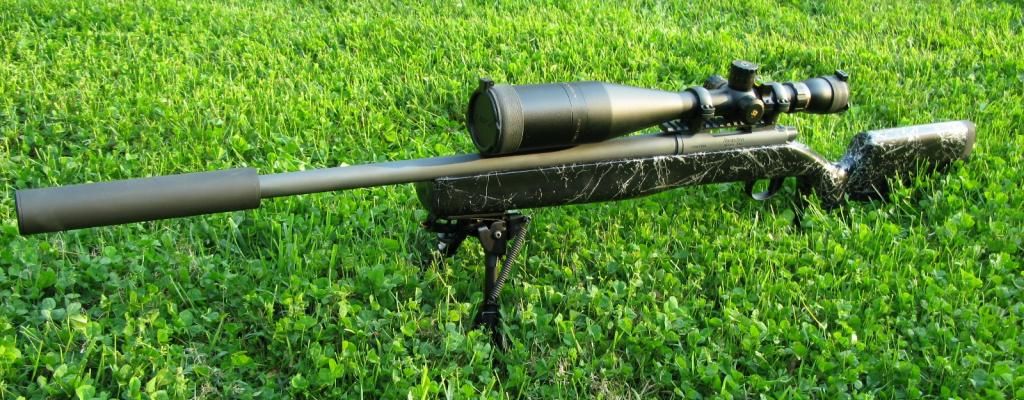

so i was going to setup my current action for a 220beggs...but have gone another route and purchased a new action instead and it will be a 6br as to appease my original desires. With the current gun, i'm going to pull the barrel rebarrel, keeping it 223ai since i'm at ~3500rnds. I've just got too much invested in the dies/brass/powder/etc... to just turn my back on it.
So right now i have:
true'd rem 700 action via Scout Supply Company
factory rem tactical 1:9 barrel rechambered to 223ai (0" freebore) and threaded for my Liberty Torch
timney 517 trigger
sightron Siii 8-32 moa-2 mounted to a 0 MOA EGW hd rail via burris signature Z rings
bobby hart lrt stock
shooting from a harris
and the bolt has been fluted via Long Rifles, Inc and is at SSC for coating right now
I'm waiting on a Cowan rest to show up (finally got one after being on the list since last year) and I'll be changing to an ST1000 (lucky to have Bill local) and I'll also be changing to a Jewell trigger.
I'm thinking the last thing I need is a decent barrel.....so I'm buying a 1:8 twist, but am unsure as to where to go. I know that Russel usually will get barrels from bugholes..and he's got these in stock:
1. Bartlein Rem Varmint 27"
2. Bartlein Heavy Varmint 29"
3. Muellerworks M24 27"
4. Muellerworks Rem Varmint 27"
so if I go to order a barrel Friday....those are pretty much my choices. I'm thinking the Bartlein HV is gonna be my choice, since i'm restocking...inletting won't matter much.
I'm planning on loading up on some 80gr amax's and running them with some RL15 or 8208.....
so....here's the questions, there's always questions
1. What length should I finish the barrel at? I have no class or weight to meet...I just shoot for fun.
2. What freebore should I have SSC run into the chamber? The gun will be a single shot only rifle...no mag length to worry about. Russel has the 0" freebore reamer and a throating reamer so I can have it setup however needed. I don't have an 80gr's on hand to see how deep I'd like to seat...so maybe someone can shed some light on this for me!
thank you guys...maybe this will be the last thread I have to make for a while since stuff is actually getting built, finally!
