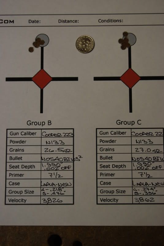

Here's some targets shot during load development for my Cooper M21 VR in 223. Nuthin' spectacular, but definitely "minute of rat" seated just shy of the lands at .002":
