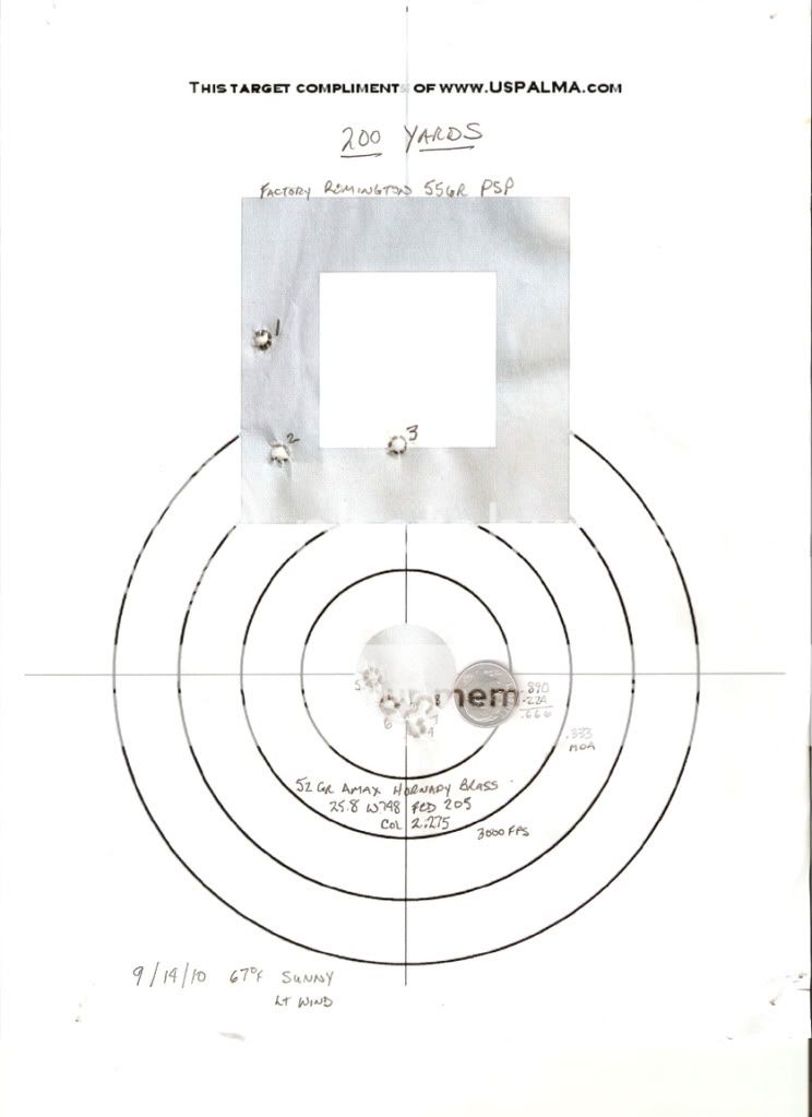

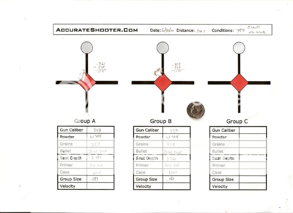

I have the same Ruger rifle, I've been getting real tight groups (sub.25") @100 with 52 SMK or A-Max with loads of W748 25.8 grains in Win/Hornady/Lapua or 26.1 grains in R/P.
200 Yards with 52 A-Max, not so good with factory 55's in box target . . .
