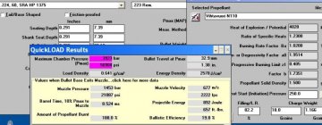

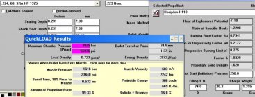

So anyone have Quickload that would be willing to plug a couple numbers for me?
These are the best options and they are the absolute maximum with 60 grain bullets!
Average Joe, please start 10% lower and work up carefully.
This stuff has not been tried and may not be safe.
I didn't include the results with the 55 grainers but the highest speed obtainable is 2330fps with 20.7 grs of H 110.
