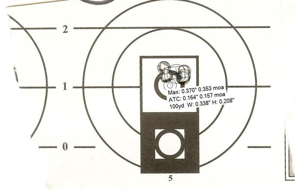

Was doing load work on my 308s this morning and I took the 223 with some left over bullets. There was a used bullseye target at 100 yards with an unmarked last target, so I zeroed on some shot up target then shot a group. I don't shoot groups for crap. I called the 1st high left flyer, not sure on the 2nd.
The 3 shot group is a .090. The flyers are the 3rd and 5th shots. This tells me if I miss, it's me.
