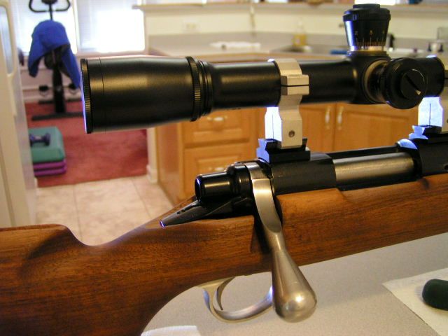

I'm assembling a 40X and have 4 bbls currently fitted to this action. A 12 twist 223 factory sporter bbl, a 14 twist 6 PPC bbl and a 14 twist 6 Beggs bbl [ and a 221 FB that I won't be shooting at 500 :) ].
I only have a lot of ammo for the 223 bbl so it's the natural one to experiment with. I have a variety of factory ammo from 45 grs to 55 grs. The gun will have a T36 scope on it. Rimfire 40X stock. Jewel BR trigger. I will either make a BR glide plate for the forend and use my windage/elevation BR rest or use a Harris bipod. Rear bag.

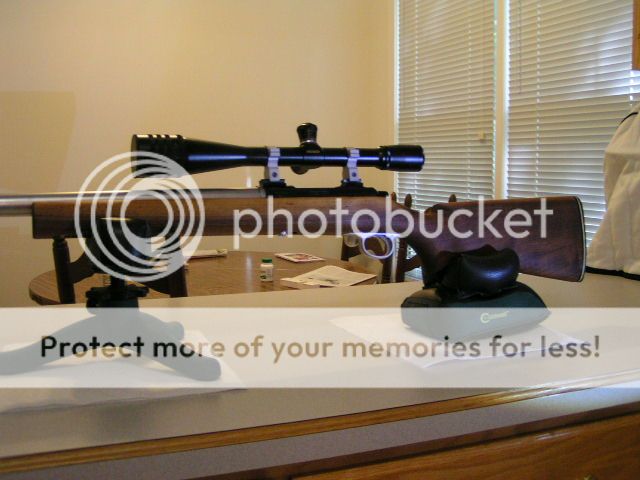

Hoping to hit the range next week. Rifle is ready. This is the 221 FB bbl which is the fattest one that will be put on this rifle. If it fits all the others will with no problems.
