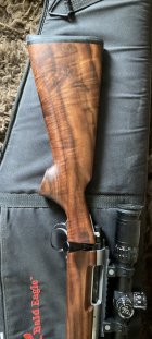

Duplicating cost including return shipping was $300. Mr. Rossiter understands how to run his machine and what is required to do to allow proper final inlet without gaps. Quality stock duplication does not equal drop in fit. I had somewhere around 4 hours
(all with scrapers) to get barreled action into stock. Couple hours in final shaping, pillar install, pad install bedding and sanding out in prep for sealing. No clue how many coats of finish. Used Pro Custom Oil for sealing and finish.
