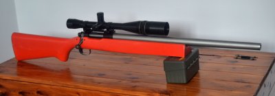

Yours is very nice shooting indeed, Nice Rig man
Is that an XP-100 with a Model 7 bolt?

It is a XP100 and just changed the bolt handle . Can't remember but don't think the 7 was out at that time . This gun was built in 1978 . Yes I have used 748 one of my favorite powders . Right now I'm using PRP bullets , and I don't like Nosler . Going to try AA2460 next .
