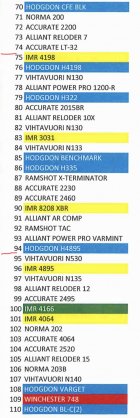

I would try other powders, simply because of my bias against BLC2. I got a can of it back in 1988 for a .222. Starting at the listed starting charge, I proceeded to blow the primer and ruin the extractor on a 722 the first shot . Had the extractor replaced and pulled all loads. Starting over, I re-weighed a charge and loaded one round. Blown primer. Switched to H322 and all was well. I later found out that there was a lot number that had problems and was hot. Pre-internet, so info was slow to get out. Just never trusted it again, though I know that is a little unreasonable. Too many suitable powders out there for me to revisit BLC2.
Back to the .222. Up until my current 700 BDLs current factory. 222 barrel my powder for 222s was always 4198. When I had this new .222 factory sporter barrel installed it was terrible with everything I tried. I was ready to order a custom barrel but a long time friend swore by H4895 in is several bench. 222s. I tried it, it's amazing. With Bart 52 gr bullets it shoots like a built varmint rifle.

JLorenzo, the .222 Rem is generally a laser accurate caliber, or has that potential. While the powder you have is not ideal, you can’t load what you don’t have. If you have the opportunity in the future, grab some H322, H4198, N133, or similar for the .222. In the meantime, I like to follow the Hodgdon load data. I know you have 52gr bullets, but Hodgdon only lists BLC-2 in 53gr. If you can find them, Sierra 53’s shoot quite well for mass produced bullets. I have no first hand experience with the bullets you mentioned. Set them .015” off the rifling, and have fun.
