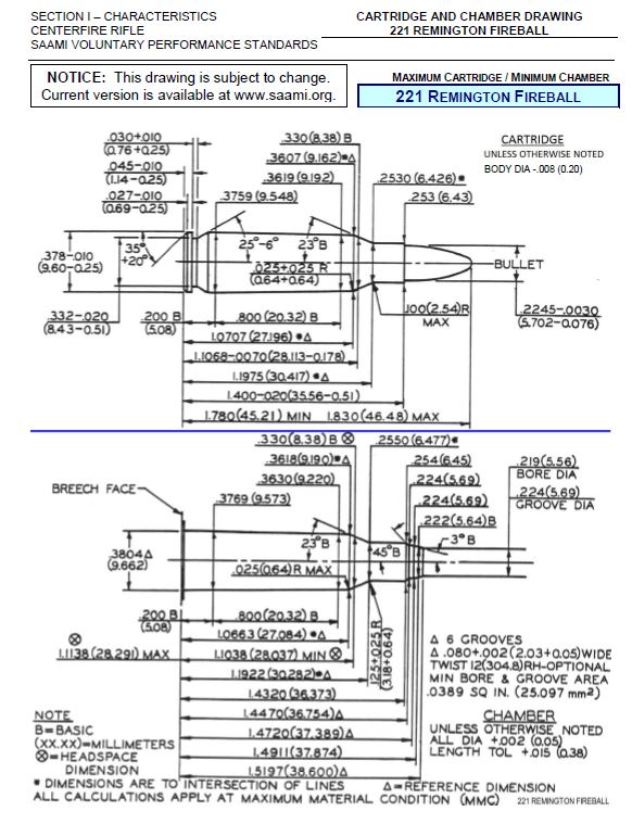

So, I have the Redding 221 forming die, and the Redding FL Sizing die, so I'm ready to make 221 FB brass. I just did a test run on a piece of Remington .223 brass, and it looks great, but I don't know what the correct wall thickness the necks should be. My Vartarg is good at .0120" wall thickness...
Can someone tell me how thick the neck wall should be? I turn my 20 VT brass when I make that from LC, I assume the 221 FB brass would also need to be turned
Question #1, please let me know what you 221 FB guys suggest for correct Neck wall thickness.

Mike, most of my Rem/Win 223 and 221 brass loads out at .248 +/- outside neck diameter, which would translate to a nominal .012 neck thickness and that is what I would do with brass for sale to the general public. There are quite a few bolt guns with custom chambers with .250 necks.
I turn my necks on 221FB, 20 VT, 20 SCC brass all to .012, when I form it from LC.
From what I could find in searching, unless someone has a custom chamber, the nominal neck thickness for 221 FB cases would be .012 to .011 thickness, yielding about .003 clearance per side in the necks after loading.
When I'm making 20 Vartarg from Lake City, the neck walls start at about .0155, same with the RP case I did as a test. That would not fit in any chamber I know of. So, yeah, I turn my 20 VT cases to have a .012 neck wall. And likely that would work for most people who might normally buy and use factory 221 FB brass guess. I would say, in general, for the 221 FB they would "need" to be less than .0155 thickness, so need to be turned. I was just trying to find out what factory 221 FB brass neck thickness has as a neck thickness, for a common chamber. I have no factory 221 FB brass on-hand to check. I think Lapua is thicker than RP or Nosler.

I just measured quite a bit of new factory Remington .221 fireball and all were between .011 and .013 indicating turning to .012 would likely replicate the factory brass.
