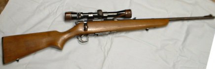

Bought my first Hornet used in 1987 in the form of a Savage 342. Love the gun and the caliber and still have it. It shoots great and I've run 1000's of rounds through it. After I got my bore scope, I figured out why the cases have always been sticky on extraction. The bore and chamber both have some pitting. That's not on me but it is there none the less. Don't have the heart to change a thing on it. It pretty much made me the small caliber nut that I am today.
