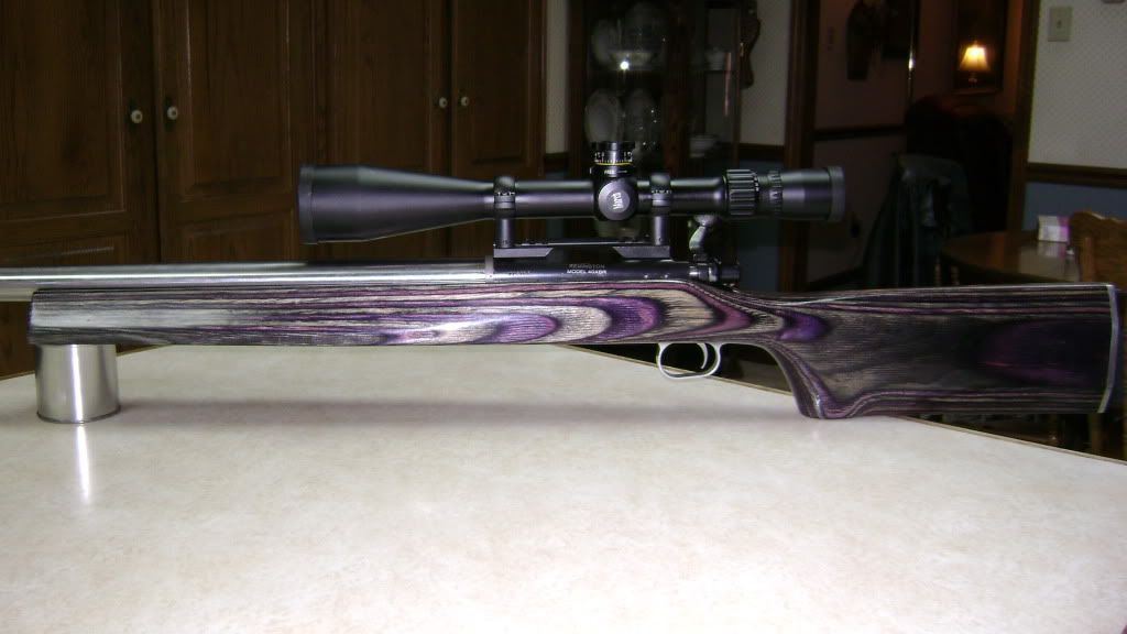

Birdog,
That is a beauty for sure, I should use peoples username's instead of your real names, yours isn't to bad but FroggyOne2 almost gives me Carpal Tunnel spelling it out so I used his name instead but when you both share the same name I guess it isn't smart,...sorry. FroggyOne2 do you think the added velocity of a 22brx or Dasher over your .223 that your 1:7.2 would still work? I know your shooting the big 90's and quite well I might add :)
