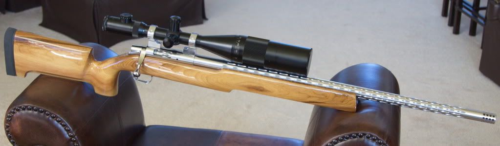

This is the 22BRX that Tommy Shurley ( http://shurleybrothers.com/custom-rifles.php ) recently built for me. This thing flatout shoots. This gun is much more than I expected. I have a 1-10 twist BRUX barrel for shooting 69gr JLK bullets. Don't think I'll be testing any new bullets for this gun in the near future. :) Tommy really does fine work as I found out with this build (my first with Tommy). Can't wait till Spring gets here so I can get to the range and do some shooting.
Very Nice.
Not to bad for a guy in North Central Arkansas... Just kidding Clayton ( Tommy) and I go back a few years. We met at the Little ROck Range in 07 i think.
