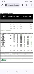

Does anyone have any reloading data available for the 22arc using N540 powder, 80 grain Hornedy eldx that you would be willing to share?
Thanks in advance.
That data looks sketchy. They have SW Precision at a much higher charge than Varget, and N540 lower. 540 is slower than Varget and SW Precision is basically identical. The real red flag, is they have a higher charge of Staball Match, than PP2000MR or CFE223, and both of those are much slower burning than Staball Match. Another quick note, the 80gr Sierra MK has a bearing surface about .040" shorter than the Hornady or even the Berger vld.
