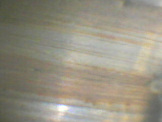

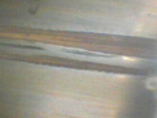

Long story short, after inspecting with the scope, it was no wonder that one particular barrel was such a copper magnet. What was a surprise (to me) was that a white patch is no guarantee that all copper has been removed.
After cleaning w/conventional solvents (including occasionally with JB and Gold Medallion abrasives) and achieving the white patch. This was a factory barrel, after having been lapped. Wish I had taken some before lapping pics, but I didn't.

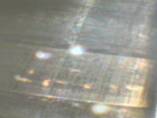

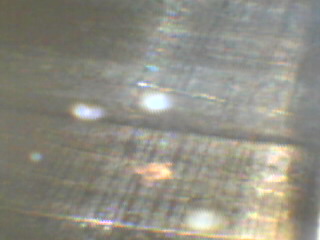

This picture is another factory barrel which has not been lapped. Both shoot moa, but the .308 (above) barely, and with only 3 (of dozens) of the bullets tried. The .338 WM below shoots .210 gr. NP's in the .5's w/boring regularity and sometimes better with NAB's & NBT's. Just goes to show you, some pretty rough bores shoot surprisingly well.
This barrel had been cleaned and put away after achieving the "white patch", using my old conventional cleaning procedure. Tool marks are quite visible and the large copper patch in left picture was a fairly large pit. Suspect this was a flaw in the barrel blank but cannot be sure as I was not original owner of this rifle.
